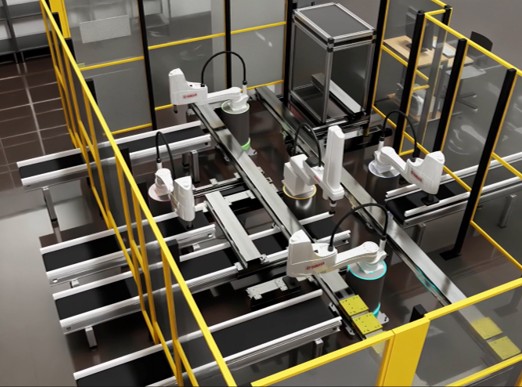

The FactoryLens Add-on provides photorealistic visualization of Visual Components layouts using NVIDIA Omniverse and RTX rendering technology.
FactoryLens can be used to review layouts, create visual presentations, and export content for external use.

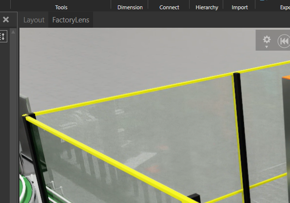

Using the FactoryLens Viewport
FactoryLens provides an alternative viewport for viewing layouts.
To open the FactoryLens viewport:
  1. Go to the Home tab.
  2. In the FactoryLens group, select Viewport.
The FactoryLens viewport opens and displays the current layout using RTX rendering technology. Any changes made in the layout are automatically reflected in the FactoryLens viewport.
You can switch between the standard Layout viewport and the FactoryLens viewport at any time.
Exporting from FactoryLens
You can export the current FactoryLens view as an image, video, or USD file.
